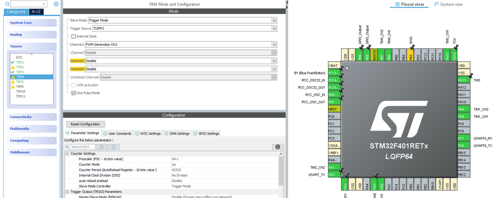

This sensor works well when I connect it to a pin with a GPIO input. Yet when I plug it to the input of the one pulse mode, the sensor doesn't work at all. It seems like all the current from the sensor is drained by the MCU. The configuration of the one pulse mode is on TIM4 and is showed below.

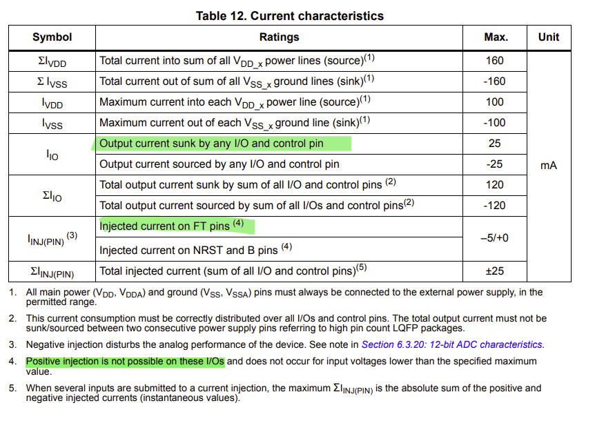

I read the documentation about the injected current required to trigger the input from a one pulse mode but I only saw these values for input/output below:
I also think that the fact to switch in one pulse mode add a resistor connection on the input pin but I found nothing about it...
It would be important because I would like to add a comparator circuit between the one pulse input pin and the endstop sensor.
