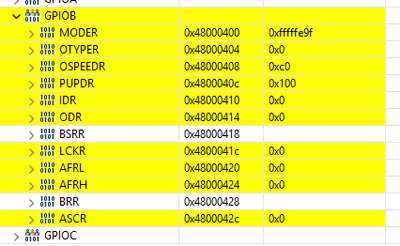

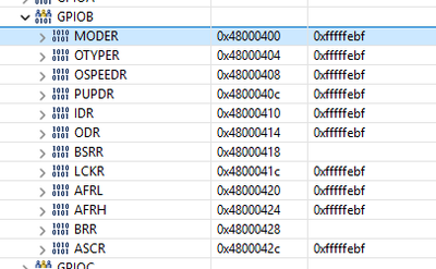

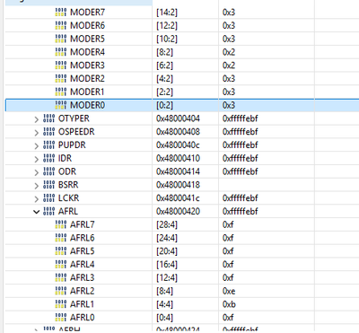

The GPIO is configured as such, looking at the registers:

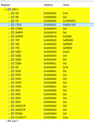

And the ADC (DR is 7B/123 because right now the triggers are slow):
Ok, so... What am I getting wrong? Why does it not read the opamp? Any more info required I shall grab it!

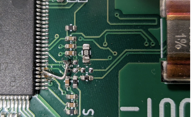

2025-08-16 2:33 AM - edited 2025-08-16 3:13 AM
I have just made a board patch using tiny little wires between the opamp output and the ADC input on a different pin (PA5, ADC1 in10).
It works instantly. With this setup, the OPAMP channel also responds a bit (I set injected conversions to measure bothPA5in10 and PB0in15) but the PB0 response is about 1/3 of the response from the PA5 pin.
I think there must be some error in the ST HAL/CubeIDE configuration mechanism (or a silicon bug?) that prevents the ADC from reading the opamp when configured with the pin in dual mode.
Modifiet board that successfully reads current on PA5

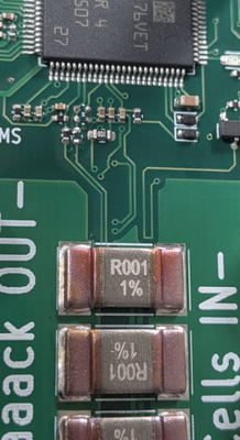

Un modified board fresh from factory
2025-08-16 5:34 AM
The GPIOB registers you've shown indicate, that you don't have GPIOB clock enabled in RCC.
I don't know whether this is the cause of your problems. I don't use Cube/CubeMX.
2025-08-16 6:14 AM
Still no joy.
The original project did have these enabled, since CAN, GPIO, PB2,PB12,13,14... every PBx pin was enabled.
I just enabled them on the dummy project and no change.
