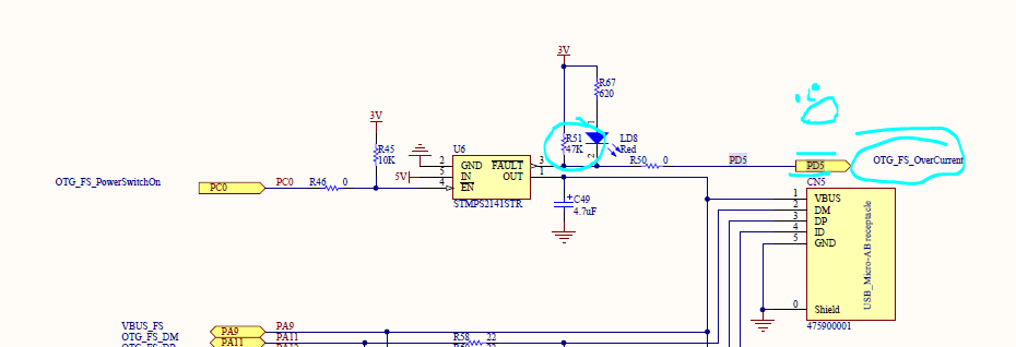

You didnt specify , but if you are using a STM32F4DISCOVERY board (making a guess here).
The Pin D5 is tied to the USB otg current sense, this could be the reason youre unable to see 0v. (remove the R50 bridge to release that D5 from the usb otg IC )
https://www.st.com/resource/en/schematic_pack/mb997-f407vgt6-c01_schematic.pdf

2022-05-20 4:59 PM
You have one hell of a top-notch crystal ball!
