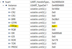

timeout is generated if RTOIE bit in USART_CR1 register is set.I stepped thru the code of HAL_UARTEx_ReceiveToIdle_DMA:
It seems that CR2.RTOEN and RTOR.RTO are not configured. Nevertheless, I get an DMA done event via HAL_UARTEx_RxEventCallback after data received.
