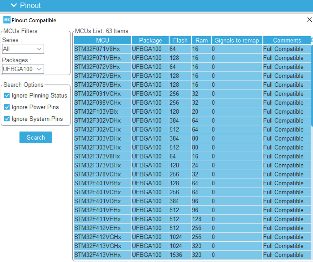

2022-02-04 6:41 AM
Look at Pinout -> List pinout compatible MCUs in CubeMX. Here is a partial list. Exact compatibility depends on the pins you're currently using.
