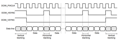

Regarding the meaning of "active high", for example, if VSYNC is programmed active high:
• When VSYNC is low, the data is valid.
• When VSYNC is high, the data is not valid (vertical blanking)
The below figure shows an example of data transfer when DCMI_VSYNC and DCMI_HSYNC are active high, and when the capture edge for DCMI_PIXCLK is the rising edge.
For more information, I advise you to take a look to AN5020 and precisely 5.4.1 Hardware (or external) synchronization section.

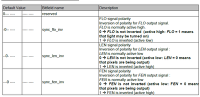

This makes sense you've confirmed my suspision that ST is refering to the "active" state as the state where data is not valid or point of line sync, in which blanking data is sent. This is the opposite to what my sensors datasheet is refering to as the "active" state. See image from my imagers datasheet below where LEN is HSYNC and FEN is VSYNC:
It's not that I was inverting the syncronization, what is referred to in my sensors datasheet as active low or active high is flipped compared to how ST describe it. To be honest I think STs terminology is better, for the most part I think its what is considered standard, though I am not the only one that realised this terminology is confusing See this post.

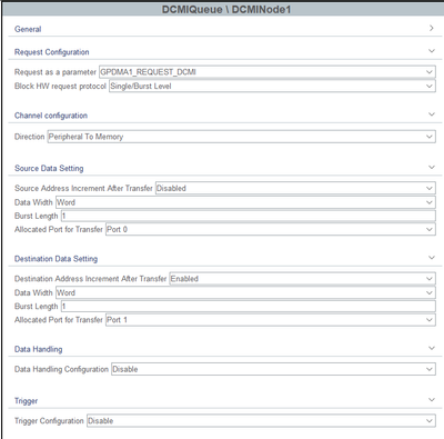

When I use these arguments I get an DCMI_FLAG_OVRRI after receiving half the data into my buffer. If I instead configure my imager to output a 360x360 image and change my length in the start command to 360*360/4 I receive all 129600 bytes as I would expect from a 360x360 monochrome image. I don't understand why I would be be getting an overflow error if I haven't exceeded any size limitations. It's almost as if the Data width of word isnt being set, and half word is being used instead, but my LINKED_LIST settings in cubeMX, the data width is deffinitly being set to word, the settings are as follows:

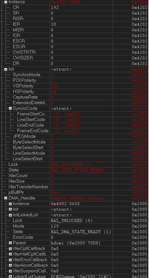

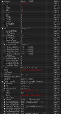

Here are my dcmi handle values before the request:

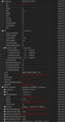

After the request (but before error interrupt):
and after the error interrrupt:
I cant tell exactly whats gone wrong, as far as I can see it got half way through the 2nd XferCount then hit an overflow error but I don't know why this has triggered.

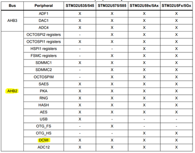

Are you using other peripherals with same DCMI bus "AHB2".

Other than SPI1 for the sensor config, TIM1 for a usec tic and USART1 for serial debugging, the only Peripherals on the AHB2 bus I am using based on the STM32U575 datasheet are GPIO.
