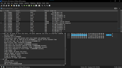

2024-06-05 7:56 PM - edited 2024-06-05 8:01 PM
Hello @FBL,
See attached 7z file. Your forum for some reason believes that zip files are a security risk, but rar and 7zip are not. Crazy.
I can't tell you what's happening on the wire, but the two wireshark capture files therein show you what's happening at the URB level (and their timestamps). There's not much to see. One of them (the fast one) has an IN URB submitted at the start of the communications, and the other - doesn't. This small difference causes throughput for one case (with IN request) to be 950kpbs but only 545kbps for the other version (no IN request) .
Both captures are of a small libusb based host-side application I adapted from some online code, which runs in libusb async mode (if you're familiar). Essentially, I have an API call which sends an IN request before starting the HOST->DEVICE continuous transmission. I can comment out the line or not, and this causes the difference.
The "fast" version overall corresponds to what wireshark captures when I use dd to send data to the device. for some reason, dd also submits a phantom IN request before starting. I've searched high and low, and asked on the libusb mailing list, and found no evidence that the USB spec requires this odd behavior.
I did these test on an old linux box which has an ICH9 controller. The STM32 code is just the basic code generated one (as far as I can remember). main is just an empty loop. Here is the callback code. As you can see the receive callback does nothing but acknowledge the packet. If I recall correctly, the transmt calback never gets called anyway (since my firmware never sends anything).

My host application measures throughput, but this corresponds well to what the device sees (I did other tests to verify this). The throughput measured by my application also corresponds closely to what `dd` reports as its average throughput (it just sends to the device as quickly as possible).
Looking forward to your insights,
Barry
