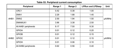

2025-02-15 11:22 AM
Good.
I just checked in ds peripheral current - and it looks not so bad:
