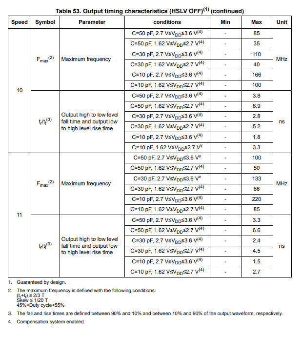

I couldn't find it in the datasheet,, what capacity is this

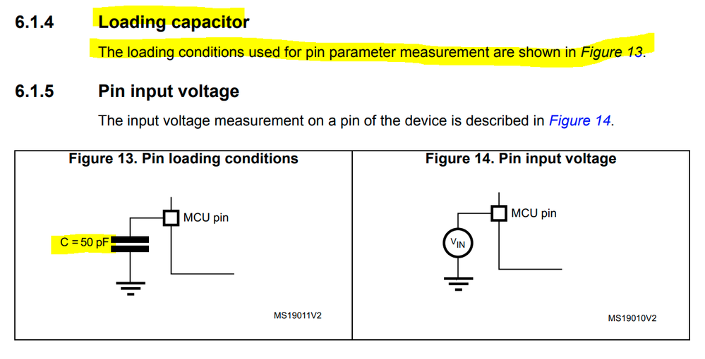

It's described in the datasheet:

It is the load capacitance, resulting form the connected inputs and connecting copper traces
