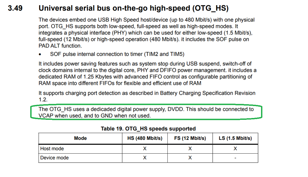

Yes, Indeed here an extract from the datasheet also .
Cheers,
STOne-32

Ok so then in my case where I will be using the USB, but not use it as an OTG device, what should I do then? I will only use it as "device" (i.e. not "host").
Hi @DanielPi ,
USB_OTG is the name of our Peripheral that is generic and able to handle many USB fonctions by software: Device , Host , OTG , PD with combination of different speeds Including Internal and external PHY for High speed operations.
So in your case , Yes , in USB device it is required as it power the digital core with 1,2V rail .
Hope it helps , STOne-32
