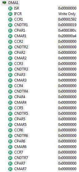

Overview: I have two external inputs. The one is the clock for TIM3 which I am using as a counter. The other input resets TIM3. Compare reg1 on TIM 3 triggers an interrupt, the interrupt enables the slave mode of TIM4 which is being clocked by the system clock. When the count reaches the TIM4 compare 1 value I want it to trigger the DMA. In the debugger I can see that TIM4 is counting up. The DMA registers all stay unchanged and the interrupt at the end of the DMA output is not triggered. Sorry about the pastes but program is made up of multiple modules, but here are most of the settings Prescaler value: PrescalerValue = (uint16_t) (SystemCoreClock / 8000000) - 1; The system clock is 72Mhz The compare values are: TIM4X_OFFSET == 20
TIM3 START1 == 24
TIM3 END1 == 312
DMA output in debugger

2015-10-16 3:22 PM
Honestly, while I asked you to post the DMA registers content, I expected this will trigger your curiosity and you will check this yourself:
> CCR1 == 0x1592 the .EN bit is not set, thus the DMA channel is not enabled. I don't use any ''library'', but there must be some DMA_Enable() or similar function to enable the channel. JW2015-10-17 6:53 AM
Thanks to those who gave advice.
After a lot of trial and error I created a simple test program and got it working. I have posted it below for anyone else who wants to see how to do it. Note that I am only sending out of the SPI MOSI. I am not using the SPI clk in this example, so if you need to use SPI with clock then you might need to change the SPI settings. Please note that this is my first attempt at programming an ARM so there may be some major bugs here.//AIM: Send data from a buffer to SPI 1 row at a time using DMA

TIM_ARRPreloadConfig(TIM4, ENABLE); //??
TIM_SelectMasterSlaveMode(TIM4, TIM_MasterSlaveMode_Enable);
TIM_SelectOutputTrigger(TIM4, TIM_TRGOSource_OC1Ref);
TIM_DMACmd(TIM4,TIM_DMA_CC1, ENABLE ); // Enable TIM1_CC1 DMA Requests
//Interrupt setup
//Enable DMA1 channel IRQ Channel
NVIC_InitStructure.NVIC_IRQChannel = DMA1_Channel1_IRQn;
NVIC_InitStructure.NVIC_IRQChannelPreemptionPriority = 0;
NVIC_InitStructure.NVIC_IRQChannelSubPriority = 0;
NVIC_InitStructure.NVIC_IRQChannelCmd = ENABLE;
NVIC_Init(&NVIC_InitStructure);
//DMA1 setup
//Transfer Data to SPI2 from RAM buffer
//Trigger from TIM4 OC1
DMA_Cmd(DMA1_Channel1, DISABLE);
DMA_DeInit(DMA1_Channel1);//reset DMA1 channe1 to default values;
DMA_InitStructure.DMA_M2M = DMA_M2M_Disable;//channel will be used for memory to SPI transfer
DMA_InitStructure.DMA_Mode = DMA_Mode_Normal;//setting normal mode (non circular)
DMA_InitStructure.DMA_Priority = DMA_Priority_Medium;//medium priority
DMA_InitStructure.DMA_PeripheralDataSize = DMA_PeripheralDataSize_HalfWord;//source and destination data size half word=16bit
DMA_InitStructure.DMA_MemoryDataSize = DMA_MemoryDataSize_HalfWord;
DMA_InitStructure.DMA_MemoryInc = DMA_MemoryInc_Enable;//automatic memory increment enable.
DMA_InitStructure.DMA_PeripheralInc = DMA_PeripheralInc_Disable;
DMA_InitStructure.DMA_DIR = DMA_DIR_PeripheralDST;//Location assigned to peripheral register will be destination
DMA_InitStructure.DMA_BufferSize = COL / 2;//amount of data to be transfered - divide by 2 because we using 16bit
DMA_InitStructure.DMA_PeripheralBaseAddr = (uint32_t)&SPI2->DR;//source and destination start addresses
DMA_InitStructure.DMA_MemoryBaseAddr = (uint32_t)MemBuf;
DMA_Init(DMA1_Channel1, &DMA_InitStructure);//send values to DMA registers
DMA_ITConfig(DMA1_Channel1, DMA_IT_TC, ENABLE);// Enable DMA1 Channel Transfer Complete interrupt
//SPI setup
SPI_InitStructure.SPI_Direction = SPI_Direction_1Line_Tx;
SPI_InitStructure.SPI_Mode = SPI_Mode_Master;
SPI_InitStructure.SPI_DataSize = SPI_DataSize_16b;
SPI_InitStructure.SPI_CPOL = SPI_CPOL_High;
SPI_InitStructure.SPI_CPHA = SPI_CPHA_1Edge;
SPI_InitStructure.SPI_NSS = SPI_NSS_Soft;
SPI_InitStructure.SPI_BaudRatePrescaler = SPI_BaudRatePrescaler_8;
SPI_InitStructure.SPI_FirstBit = SPI_FirstBit_MSB;
SPI_InitStructure.SPI_CRCPolynomial = 7;
SPI_Init(SPI2, &SPI_InitStructure);
//Connect output to alternate function - AF2
GPIO_PinAFConfig(GPIOB, GPIO_PinSource15, GPIO_AF_5); //MOSI on SPI2
SPI_Cmd(SPI2, ENABLE);
TIM_Cmd(TIM4, ENABLE);
DMA_Cmd(DMA1_Channel1, ENABLE);
void DMA1_Channel1_IRQHandler(void)
if(DMA_GetITStatus(DMA1_IT_TC1))
DMA_ClearITPendingBit(DMA1_IT_TC1 | DMA1_IT_GL1);
RowCount++;
if(RowCount >= ROW)
DMA_InitStructure.DMA_MemoryBaseAddr = (uint32_t)MemBuf;//end of buufer reached - start at beginning
RowCount = 0;
else
DMA_InitStructure.DMA_MemoryBaseAddr += COL;//move to next row in buffer
else
DMA_ClearITPendingBit(DMA1_IT_GL1);
int main(void)
Init();
for (uint8_t var = 0; var < 20; ++var)
MemBuf[50][var] = var;//put some stuff in one row of the buffer
while(1)
//put your code here
