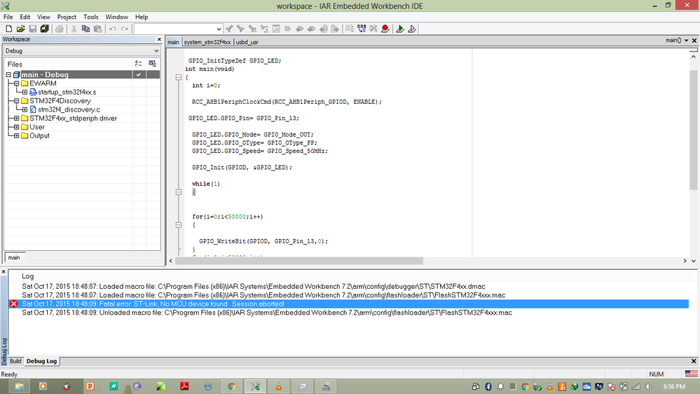

Hi! I am having the same problem with my STM32F407 Discovery board. I tried to apply the suggested solution but no progress. May be I didn't fully understand what you are trying to say.
A little elaboration will be appreciated..Thanks in advancehere is a screenshot.2015-10-17 8:17 AM
May be you can say what you actually did so I can determine if you did what I suggested or something else? A screen shot of the error really doesn't tell me much.
The suggestion on the Discovery board would be to jumper BOOT with VDD to force the chip to run the System Loader, instead of broken User Code when reset. You need to reset or power-cycle. There are also usually configuration options to permit ''Connect Under Reset'' and to make sure SWD mode is used, not JTAG mode. Would also suggest you download the ST-LINK Utilities, check if the firmware needs updating, and if you can connect/erase the part from there.We’re moving the ST Community to a new platform to give you a better and more reliable community experience.
