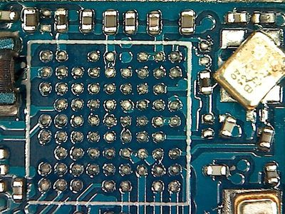

I just realized that in the Lora E5 chip the Vref+ pin is connected to Vadd pin, so that's the problem, it's not possible to use VREFBUF in this chip. In case anyone face the same problem I left here the internal connections of the STM32WLE5JC.
