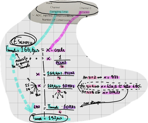

I have an stm32f407g.
In the reference manual (in the ADC section) I found several terms I am afraid I have confused between them.
I would like to explain my reasoning with an example and get your feedback if I said something wrong.
-------------------------------------------------EXAMPLE (points are in order!)---------------------------------------------------------------
Suppose I need to sample a signal and I need a Tsample = 166.6 us
I need to tell the ADC to sample with that Tsample, however, I need to convert it to cycles:
With some approximation I find 480 cycles --> Tsample = 192us (a little different from 166us but it's okay)
EDIT: I have to take into account that the datasheet says that Tconv = Tsample + 12 cycles
so actually ADC takes Tconv = 480 + 12 cycles = 492 cycles = 196.8us .. not 192us
1a) Are these calculations correct?
How long does it take the ADC to convert each sample?
It depends on the resolution, right?
If I use 12 bits, the ADC will need 12 cycles + 3 cycles = 15 cycles ... which converted to seconds are:
15 * 1 cycle duration = 15 * 1/(PCLK/Perscaler) = 15 * 1/(10MHz/4) = 5us.
2a) Are these calculations correct?
2b) Does this mean that every Tsample = 192us the ADC read a sample and takes 5us to convert it?

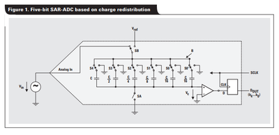

this kind of adc are capacitive SAR converters , see:
https://www.ti.com.cn/cn/lit/an/slyt176/slyt176.pdf
so: sampling time is first part of conversion, where the input cap C is connected with the input pin and charges to the voltage at this pin. then comes the fixed 12 cycles ...together this is the total conversion time. ok ?

2023-11-20 12:13 AM
So I suppose my calculation 1a) is correct ... I gave an example just so I wouldn't make a mistake.

2023-11-23 12:42 AM
I was looking for exactly this answer you gave, evidently I had not expressed myself well in my question. I was convinced that how often to sample with the ADC was decided right in the "Tsample" and "Tconv" parameters of the ADC, in fact I need to sample an input signal at about 6kHz --> 166.6us
But you told me that a TIMER is used (i.e. set it with interrupt every 166.6us).
Thank you very much, it is much clearer now!
1) Why do you say "Tsamp+Tconv less than 166.6us"?? It should be "Tconv less than 166.6us" since Tconv already contains Tsampl inside it .. right?
2) So I have to make sure that Tconv<166.6us .. and I set it by specifying an appropriate number of cycles in "Tsample" parameter of the ADC in the .ioc file and taking into account those +12 cycles in the formula:
