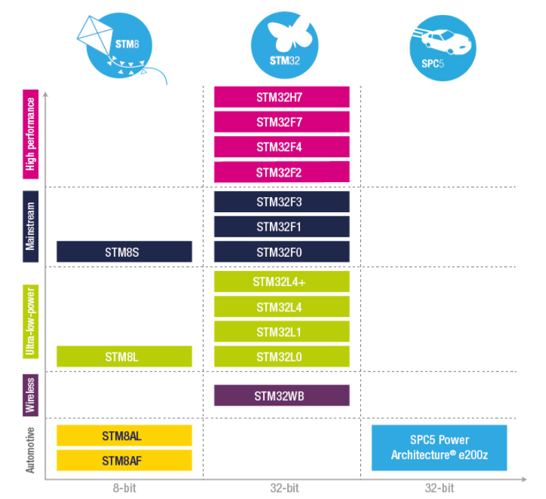

ST doesn't have 16-bit devices in MCUs portfolio. You can consider using either 8-bit MCUs (
http://www.st.com/en/microcontrollers/stm8-8-bit-mcus.html?querycriteria=productId=SC1244
family) or 32-bit MCUs (http://www.st.com/en/microcontrollers/stm32-32-bit-arm-cortex-mcus.html
family).Both STM8 and STM32 families have low-power series:
- from STM8 there are STM8L and STM8AL series- from STM32 there are STM32L0, STM32L1, STM32L4 and STM32L4+ seriesRegards
