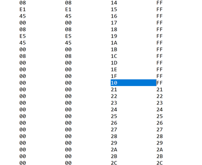

2023-12-14 5:48 AM
Hello again @TomKing
Waiting for a response from the team Internal ticket number: 168821 (This is an internal tracking number and is not accessible or usable by customers)",
However, I noted here while writing instead of 10 this should be 20. I guess this should not affect the overall behavior.
2023-12-14 5:55 AM
No, the data is not important, just to find the point when no 'FF' is read out. Value 20 comes later (after 2F).
