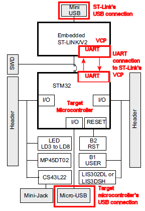

Perhaps this helps to distinguish the USB connection via the on-board ST-Link from the Target microcontroller's USB connection:

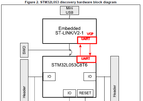

2018-02-22 2:00 AM
Neil.Andrew wrote:
There is no target software at all required to use the ST-Link's VCP connection - as far as the target STM32 is concerned, it is just a UART connection.
Like this:
