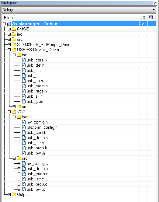

I'm trying to implement Virtual Com Port on STM32F3. I use IAR.
I've included all files from a demo project.
However I have numerous errors while compiling the project. Struggling for hours I came to this question
Is there any compiled project with VCP for STM32F3?
You're referring to this:
https://community.st.com/0D50X00009XkfBRSAZ
?As noted there, you probably just have one actualmistake - but that results in a whole load of similar error reports.
This is quite common - one mistake causes resultant errors in everything else that depends upon it.
