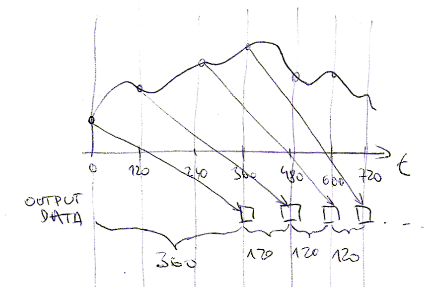

This is not a plain SAR ADC, and the digital filters inherent to sigma-delta conversion involve delays. The 120 cycles per conversion is the maximum sampling rate, but the samples are pipelined (i.e. they pass through several filtering stages) making up the 360 cycles total delay/'latency'. As the RM puts it in Continuous and fast continuous modes subchapter:
In fast continuous mode (FAST=1), the first conversion takes still 360 SDADC clocks, but then each subsequent conversion finishes in 120 SDADC clocks.

I have my SDADC in fast continuous mode.It's simply takes 360 cycles until the signal propagates from analog input to the output data buffer, i.e. 60us, that's all.
But this is only the first conversion takes ! Each subsequent conversion finishes in 120 SDADC clocks i.e 20us !When conversion time = Analog signal from analog Input to the Output data buffer then i don't understand my measurment result i.e 55us !When conversion time = only sample time without sync filter then my result is correct20us conversion time + 20 us time sync Filter = 40us + 15us (Input filter, Code, Output filter).what is conversion time ? with filter i.e. 20us

2018-02-28 7:24 AM
No. It's simply takes 360 cycles until the signal propagates from analog input to the output data buffer, i.e. 60us, that's all.

Hi JW
Thank you very much. Now i understand.
Conversion time is each subsequent conversion and = 20usBut Attention! The first conversion need 360 cycles at the phase time minimum result = 60usConclusion:
For the Phase time (Latency) only the filter is responsible.
Thanks
