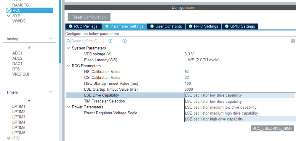

Ok, but C14 should be there. (I use 10u cer.cap here.)
Set in Cube the LSE drive high !
Then it should work.

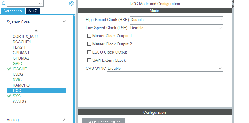

As I suspected LSE is disabled. So your crystal will never oscillate.
And you don't use LSE as clock source either.
Drive strength depends on the MCU family and used crystal. Higher drive strength consumes more current. Too low and it may not oscillate.
Check Table 7. "Recommended crystal / MEMS resonators for the LSE oscillator in STM32"
from an2867-guidelines-for-oscillator-design-on-stm8afals-and-stm32-mcusmpus-stmicroelectronics.pdf for what your MCU supports.I've had issues with using a not supported crystal with too high capacitance. It resulted in some boards not booting sometimes since the LSE init function time out. The trick was using a different crystal with correctly calculated capacitors and set the right drive strength (in our case second highest level was good).
Check the datasheet of your MCU to see what drive strength levels are supported for LSEDRV.
"Table 43. Low-speed external user clock characteristic" in stm32h563zi.pdf
2024-06-27 12:18 AM
As per your instructions, the problem was solved. We checked it a few times, each for a duration of 5 to 10 minutes, over the last few days. If any issues occur in the future, I will call you back. Thank you for your support and guidance.

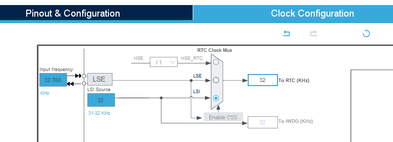

Ensure you use the internal oscillator
2024-07-30 12:36 AM
Please read this topic and other topics on RTC issues. If those don't help you, please open a new topic.
2024-07-30 12:45 AM
2024-07-30 1:02 AM
OK @unsigned_char_array we will go through it. but we get 1.2V on oscillator this means it is working properly??
