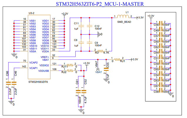

I am experiencing issues with the VBAT pin on the STM32H563ZIT6 microcontroller. Specifically, the VBAT pin is not responding properly. I am using a CR2032 CMOS battery for RTC backup, but it is not maintaining the date and time as expected. When the power supply is off, the RTC does not hold and run correctly, but it resumes running once the power supply is restored.
I have attached the circuit diagram for your reference. Could you please provide a clear explanation of the potential issues and offer guidance on how to resolve them? Expert advice on this matter would be greatly appreciated.

We are encountering issues with live date and time printing on our ODM development board using the attached circuit. Below are the details of the tests conducted:
Set Date and Time: 15/Jun/2024, 4:25 PM
Live Date and Time: 15/Jun/2024, 4:25 PM
Printed Date and Time: 15/Jun/2024, 4:25 PM
After running for 5 minutes:
The power was turned off on the DB, and after 5 minutes, we turned it back on. The system then printed the date and time as it was when the power was turned off, continuing from that point.
Live Date and Time: 15/Jun/2024, 4:40 PM
Printed Date and Time: 15/Jun/2024, 4:40 PM
After 5 minutes of power being off:
We conducted this test 4-6 times with consistent results. It seems that the printed date and time do not update correctly after power restoration.
Please check the attached circuit and provide guidance on potential issues and corrections needed.

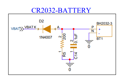

R5 is discharging the battery to GND with 15mA. That's a lot and I don't see a need for discharging a backup battery.
RJ1 is also discharging the battery by having the battery supply current to the entire circuit, it also prevents the circuit from powering off. Internally VBAT is bypassed when VCC is present, so you do not need VCC connected to VBAT at all. Remove these resistors. You don't need the diode, it just ads voltage drop. C14 is redundant because of C55 and it is behind a diode, you only need one, look at the guidelines for what capacitor value is recommended. Extra components potentially add a small leakage current.
Have you checked LSE like I told you? If you use LSE as a clock source it won't run when powered by VBAT so the value will freeze like you observed. Additionally you will see very inaccurate time keeping.Have you checked the crystal to see if it is oscillating?
