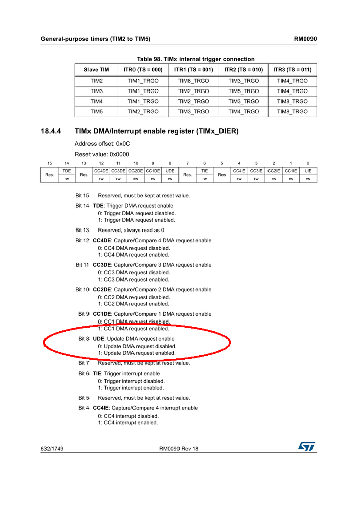

> TIM4 -> DIER |= (1UL <<(14U)); // UPDATE DMA REQUEST ENABLE
Are you sure? I don't have RM at hand but this doesn't sound right to me.
Why don't you use the symbols from the CMSIS-mandated device header?
2020-04-07 11:17 PM
2020-04-08 9:00 AM
Hi JW,
I'm sorry, I had this register set as:
TIM4 -> DIER |= TIM_DIER_UDE
and it didn't work for me so I started to mess around and forgot to put it back to what it was originally.
It is back to TIM4 -> DIER |= TIM_DIER_UDE .
The reason I didn't use CMSIS mandated header was because I was getting confused with what each one of them meant and I
went to the RM and started plugging the values from RM.
I will go back and use CMSIS defines to make it easier to read for you, thank you for getting back!
2020-04-08 9:04 AM
Whatever, just read out the registers' content and check/post

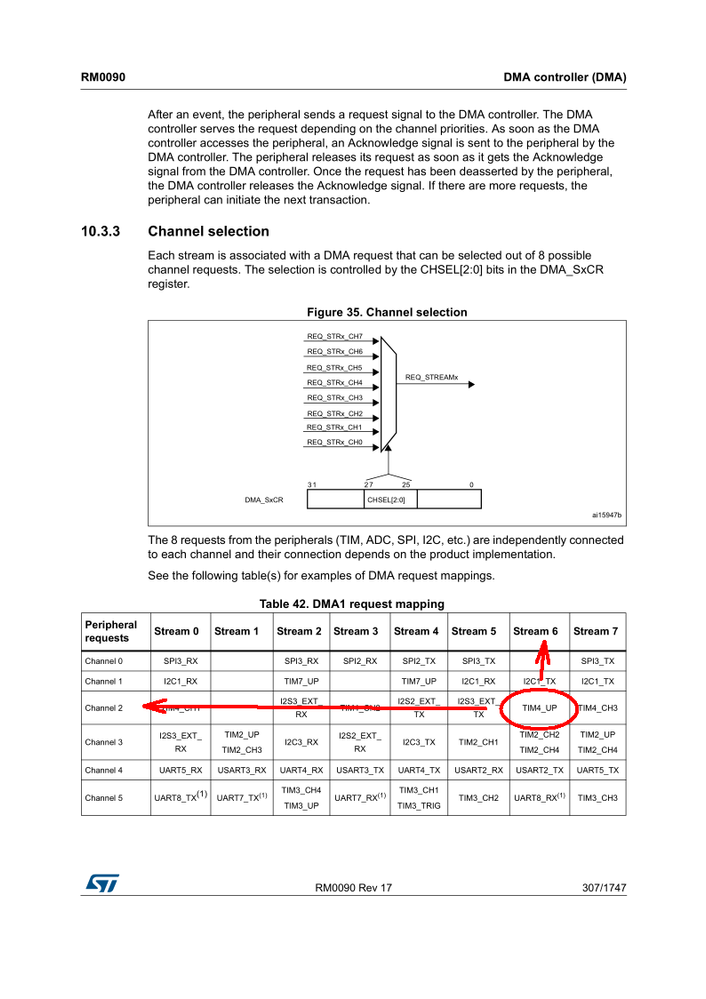

> |( 1 * DMA_SxCR_CHSEL_2) // CHANNEL 2 SELECTED
No. DMA_SxCR_CHSEL_2 is bit 2 of the CHSEL bitfield, so this sets the CHSEL bitfield to 0b100 = 4 i.e. you've selected channel 4.
You want
|( 2 * DMA_SxCR_CHSEL_0) // CHANNEL 2 SELECTED
or, maybe visually better, if you have newer header file (the ***_Pos symbols were not defined in the headers in the SPL era)
| (2 << DMA_SxCR_CHSEL_Pos)
> TIM4 -> DIER |= TIM_DIER_UDE; // UPDATE DMA REQUEST ENABLE
yes, that's better than triggering DMA from CC3, but then you need not Channel 7 but channel 6:
If after doing this still no cigar, read out the registers' content in debugger and check/post.
2020-04-08 1:28 PM
I'm sorry if I ask a dumb question,
but what is the difference between TIM4_CH3 and TIM4_UP can they be used on the same GPIO Pin?
Do I need to use different CCR registers? would it be CCR1 CCR2 or so on?
In the data sheet for the MCU Alternate functions for the pin I have to use are TIM4_CH3 or TIM10_CH1.
I am totally clueless about the TIMx_UP
