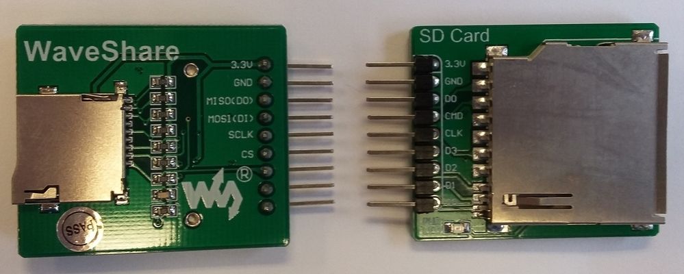

The STM32F769I-EVAL and F779I-EVAL has two microSD sockets, and support two independent SDMMC peripherals.
This kind of adapter permits the use of two different kinds of cards, but only one at a time.
