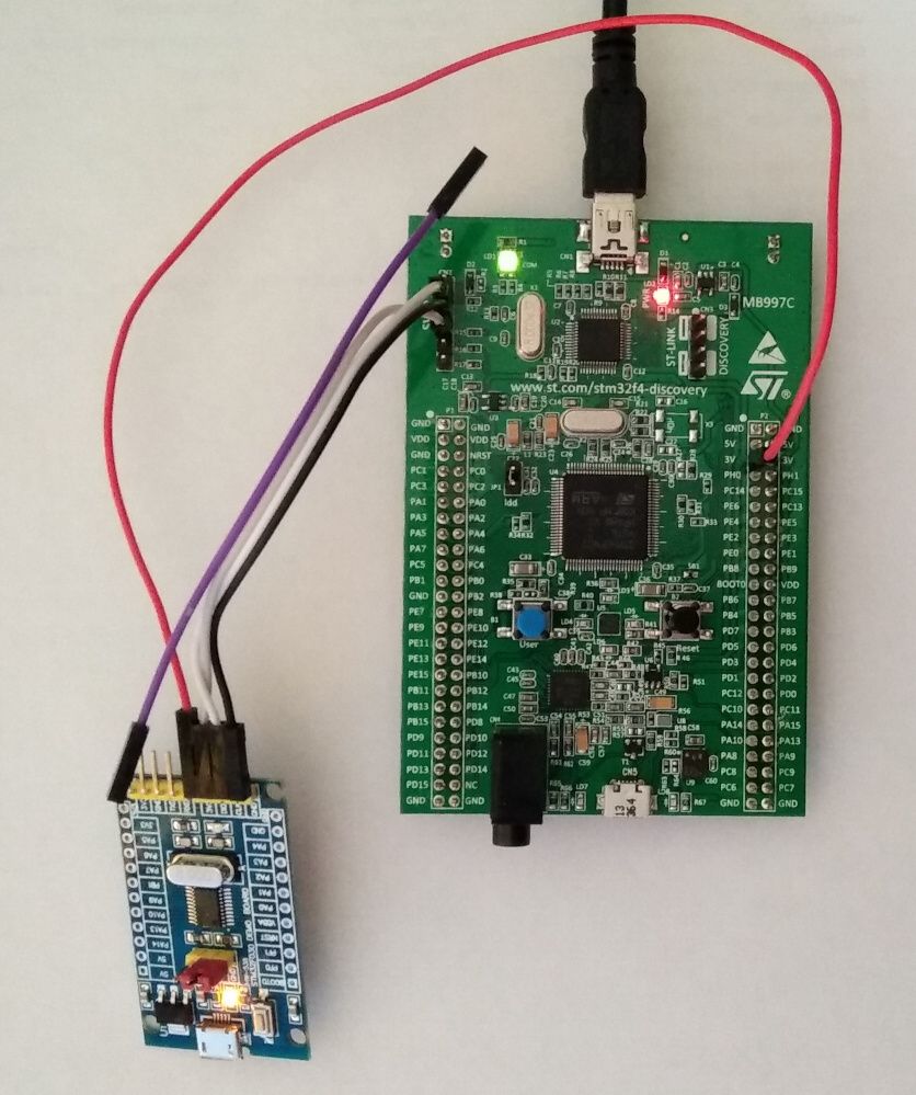

Hello. This is my first post here. I'm pretty unexperienced at the hardware side of MCU's and I want to debug my STM32F304P6 processor (on an unofficial board) through debugger of STM32F407VG Discovery Board. I connected SWD pins ( 2nd to CLK, 4th to DIO, GND to GND and 3v3 to 3.3V on Discovery) and unplugged CN3 headers. And I get can not find target error. Than I tried to connect 5th SWD pin with NRST on board but the result is same. I read the documentation and I don't know where am I doing wrong. Thanks
PS: I tried the same method with STM32F103 too. Result is same. Discovery board works well.

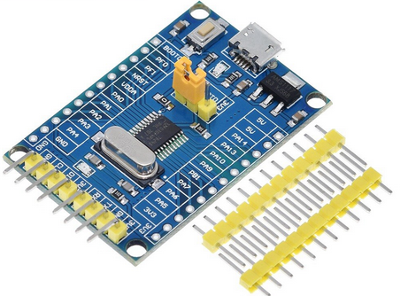

Unofficial STM32F034P6 Board:

Would you mind giving any *precise* information? E.g. there is no 3.3V pin on the discovery board, so ...?. How did you attempt to connect (which software), what's the *precise* error message you get? "I'm sure that board has power" isn't useful at all. Whether you *think* it is powered and whether it *is* powered are two very different things. Did you verify with a voltmeter?

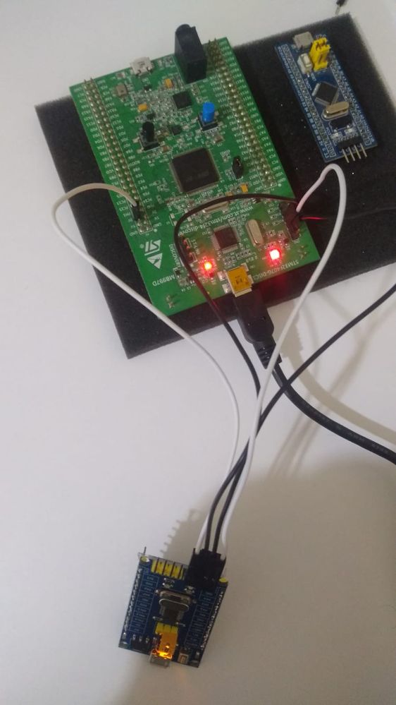

@Andreas Bolsch I did the same connections with you and tested on ST-Link Utility and STM32Cubeide by using ST Link GDB Server (sorry as I say 3.3 I mean 3 that's a terrible mistake). And having errors on both of them. I'm using latest debugger frimware on STM32 Debug+Mass Storage+VCP type. I tried on different clock speeds. Thanks for your respond

st-probe output while CN3 headers ON
Found 1 stlink programmers
serial: 303636464646333633343336344534453433303334323430
hla-serial: "\x30\x36\x36\x46\x46\x46\x33\x36\x33\x34\x33\x36\x34\x45\x34\x45\x34\x33\x30\x33\x34\x32\x34\x30"
flash: 1048576 (pagesize: 16384)
sram: 196608
chipid: 0x0413
descr: F4xxst-probe output while STM3203 connected:
flash: 0 (pagesize: 0)
sram: 0
chipid: 0x074bst-util output while STM3203 connected:
st-util
2020-11-09T19:48:22 WARN common.c: unknown chip id! 0x374b
2020-11-09T19:48:22 INFO gdb-server.c: Listening at *:4242...
