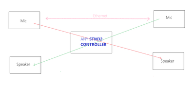

I am using STM32F407VG in my project temporarily. The objective is to transmit audio data over ethernet which is received in this mic and received audio from the other end this side having stm32 as the MCU.

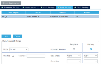

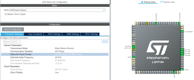

i am unable to read the I2S audio buffer properly.

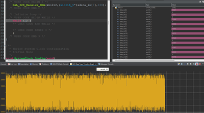

The output when i plot the variable "sample_i2s" is

Glancing over it, the output plot seems to suggest a data size issue somewhere.
Every other data item zero point to a systematic issue.

You set the DMA on word,32b, but from my experience the F4 i2s is not working correctly then. So try settings with half word, 16b, and also the data in int16 .
The i2S working correctly then.
vbk22398
Senior
@AScha.3 Will try and update you!
Same results!
