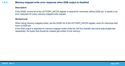

About memory-mapped write error response when DQS output is disabled errata:
If the memory does not support DQS, only 64 bits can be written which is confirmed now, there is no workaround.
Thank you.
