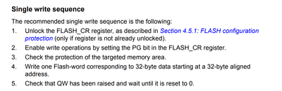

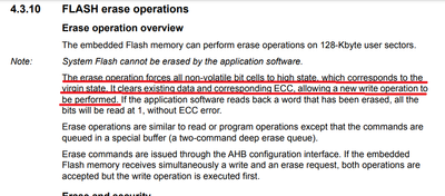

Hello, As said by @Andrew Neil this is the nature of the NOR Flash memory:
From the reference manual:
You can inspire from this example provided in STM32H7 Cube HAL:
See also this video on how a generic NOR flash memory is working: https://www.youtube.com/watch?v=V1JdpqvUIhk

Yes - that is the nature of Flash.
In STM32, you probably have to unlock before you can erase or write - check the chip's Reference Manual, and/or the HAL documentation ...
2024-11-28 3:00 AM - edited 2024-11-28 3:01 AM
