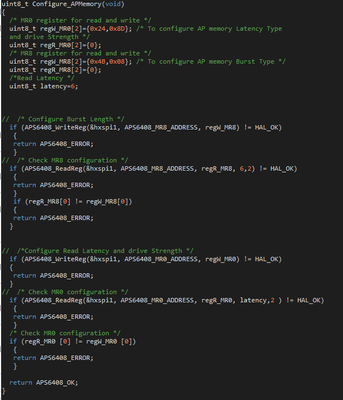

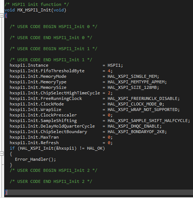

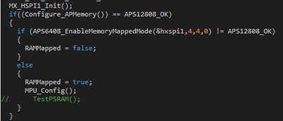

I am working on a project with TouchGFX. I'm working with STM32U5G9ZJT6 and I have an external RAM APS12808L-OBM-BA connected via HSPI (Fclk-hspi 100 MHz) in mapped mode.
The project is working, but the image animation are not working well. To solve it I have decided to increase the HSPI frecuency.

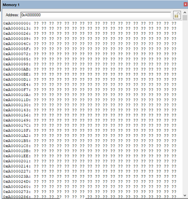

The APS12808L-OBM-BA memory can operate at up to 200MHz. However, when I exceed 118MHz, I can't map the memory. You can see a picture below reading the memory after mapping (you see "?").
I have changed the memory read latency (MR0 and MR4) to increase the Fmax.

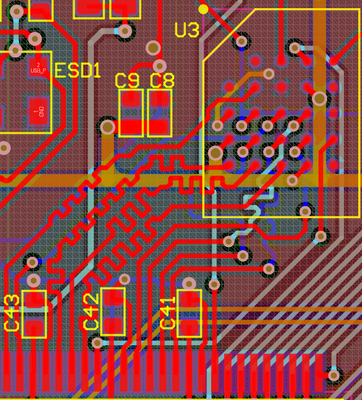

In particular, please give details of your hardware - could there be a hardware issue with speeds >118 MHz ?
2025-11-18 9:58 PM
Hi Andrew,
I have kept the same track length (about 18.5mm) and close to the microcontroller.
