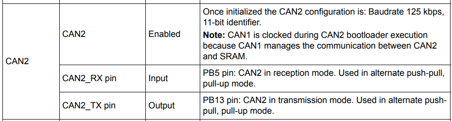

STM32F429ZI Nucleo and STM32F767ZI Nucleo share the same hardware and that article is almost generic.
Refer to the schematics: https://www.st.com/resource/en/schematic_pack/nucleo_144pins_sch.zip
In the other hand the bootloader is related to the chip itself not to the board. The only stuff to check is whether CAN2 bootloader pins (defined in the AN2606) are exposed externally to the board. Which is already the case of PB5 and PB13:
and these GPIOs should not be connected to any other electronic stuff on the board, so you need to remove JP7 jumper to disconnect the Ethernet PHY from PB13 pin.
PB5 seems to be free.
