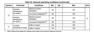

> i varied the ambient temperature
Did you go outside of the operational range of your chip? You don't mention exact chip number so only you know what this is. Datasheet specifies this.

am using STM32U585AII6Q and already enabled the MONEN bit .
and here i varied the ambient temperature from -45 to 110 degree using a temperature chamber.
