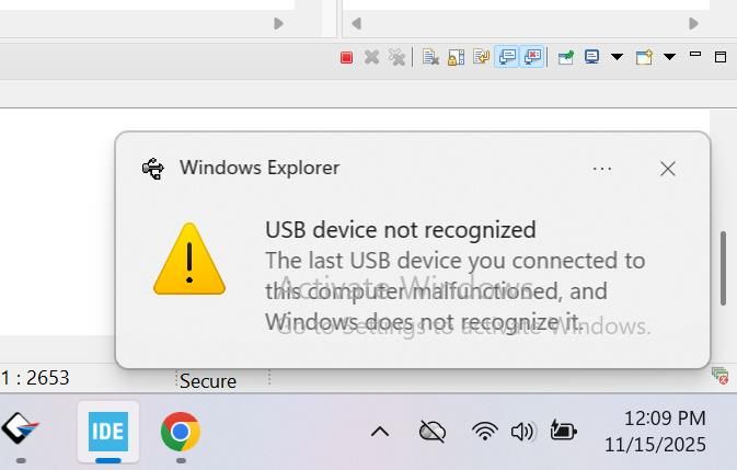

}Windows immediately shows the error:
“USB Device Not Recognized – The last USB device you connected to this computer malfunctioned.”
We are unable to detect the USB device on the host PC and we would like assistance in identifying what is missing or incorrectly configured in our USB1_OTG_HS and USBX setup.
