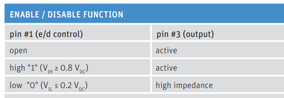

Well, the manufacturer of the oscillator should be able to answer your questions. However, oscillators are quite easy to use and only need to be connected to VCC, GND and the output to the OSC_IN. In addition, the enable pin must be connected, whereby I assume that with Jauch the oscillator is enabled with high at pin e/d and in standby with low.

And enable pin to Vcc : (= high)

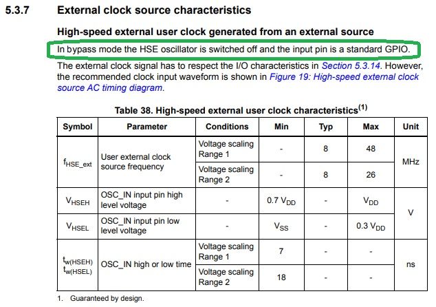

"You also on the STM32 side want to be using the HSE_BYPASS mode for a LVCMOS input rather than the side of a crystal."
What do you mean by that?
2024-01-05 12:46 PM
I mean you need to change the characteristics of the input / inverter feed back
/** @defgroup RCC_HSE_Config HSE Config
#define RCC_HSE_OFF 0x00000000U /*!< HSE clock deactivation */
#define RCC_HSE_ON RCC_CR_HSEON /*!< HSE clock activation */
#define RCC_HSE_BYPASS (RCC_CR_HSEBYP | RCC_CR_HSEON) /*!< External clock source for HSE clock */In GPIO input mode the capacitance is nominally around 5 pF, and the high/low thresholds change.
2024-01-06 2:28 AM
Where did you get the 5pF information? I couldnt find it.
2024-01-06 3:49 AM
This range is mentioned in AN2867.
2024-01-06 7:24 AM
The only 5pF i found was a shunt capacitance, and a stray capacitance in a example formula.
I would expect to find such value in the datasheet.
