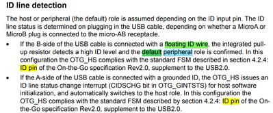

Hello @jri
The behavior you're observing, where PA10 goes high after enabling USB, is due to the internal pull-up resistor being enabled on the ID line when the USB OTG HS is initialized.
Check the reference manual section 62.5.1 ID line detection for more details.

2024-04-04 8:07 AM - edited 2024-04-04 8:08 AM
Thank you @FBL! That is what we were thinking. Is there a way to disable this check on USB OTG HS initialization, or is it something in silicon that can never be turned off?
The fact that PA10 can be switched to AF10 (OTG_HS_ID) seems to indicate that this is optional, but it looks like it always happens.

Hi @jri
Indeed, internal pull up cannot be omitted. It is necessary for the controller initialization check. By default, the controller's role is device. So, you can simply let OTG_HS_ID pin floating.
PA10 should be used only in dual role mode and OTG_HS_ID should be grounded in host role only.
