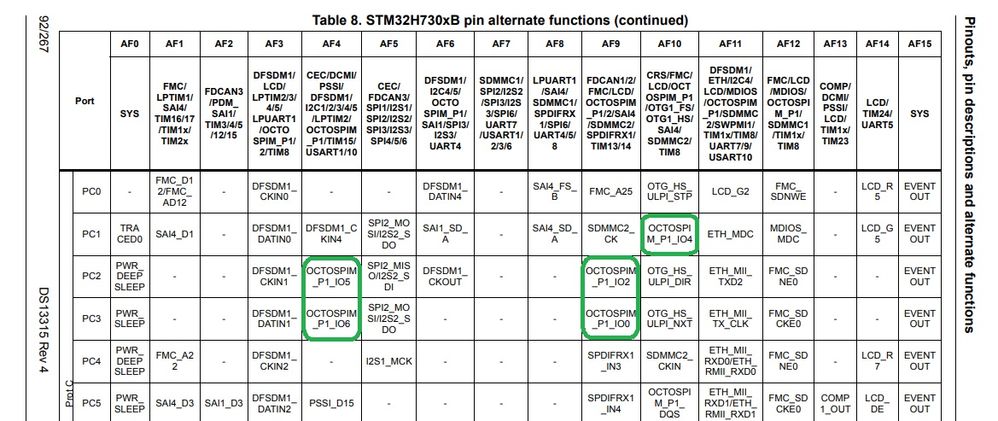

2024-12-19 5:42 PM
STM32H730 / MX25LM51245G
CLK PF10:AF9
NCS PG6:AF10
D0 PD11:AF9
D1 PD12:AF9
D2 PC2:AF9
D3 PD13:AF9
D4 PH2:AF9
D5 PD5:AF10
D6 PC3:AF4
D7 PD7:AF10
DQS PB2:AF10

2025-01-03 1:06 AM - edited 2025-01-06 11:00 PM
Thank You, @Tesla DeLorean ! Your Insight Solved It! :raising_hands:
First of all, a huge thank you to @Tesla DeLorean for the detailed response and the incredibly helpful pin configuration advice. Your expertise and generosity with your time are invaluable to the STM32 community.
The issue indeed boiled down to a misconfiguration during the migration of pins. Specifically, as you pointed out, PC3 was configured with the wrong alternate function:
GPIO_InitStruct.Alternate = GPIO_AF10_OCTOSPIM_P1; // Wrong configuration during migration
After correcting it to:
GPIO_InitStruct.Alternate = GPIO_AF4_OCTOSPIM_P1; // Correct alternate function
everything worked perfectly! :party_popper:
This was an oversight on our part, and it serves as a crucial lesson for all developers working on pin migrations, especially when dealing with custom boards or transitioning between development kits and production hardware.
When migrating pins, always double-check the alternate function (GPIOx_AFx) for each pin in your GPIO_InitStruct configuration. The datasheet and reference manual should be your best friends during this process! A single mismatch, like in our case, can cause headaches that are difficult to debug.
Once again, thank you for sharing your wisdom, @Tesla DeLorean . Your guidance helped us get the project back on track, and I hope this thread helps others avoid the same pitfall!
Cheers to an amazing community! :rocket:
2025-01-03 7:31 AM
Thanks, and pin associations are critical and easily mistyped or copied over
Sorry, I'm a bit confused about the fix,
PC3:AF4 is OCTOSPI_P1_IO6
PC3:AF9 is OCTOSPI_P1_IO0
PC3:AF10 is OTG_HS_UPLI_NXT
https://www.st.com/resource/en/datasheet/stm32h730ib.pdf#page=92
DS13315 Rev 4
