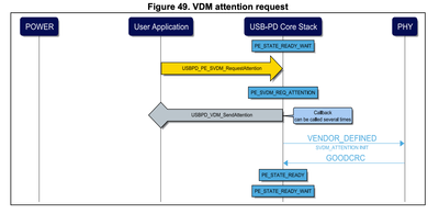

* USBPD_PE_SVDM_RequestAttention
I get a OK message response but the callback never gets called.
* USBPD_VDM_SendAttention
Curious to know if there's any good way to debug this?

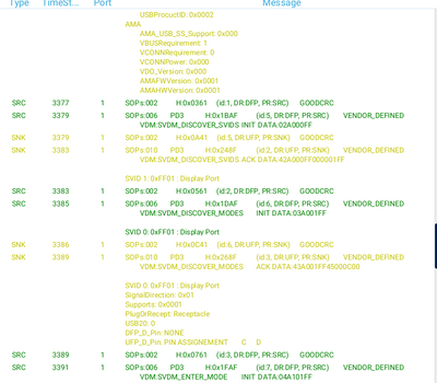

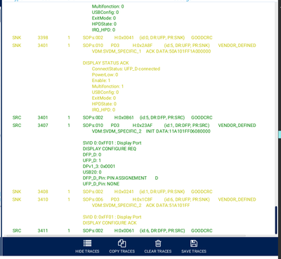

Current debugging steps
I have a STM32G0-Disco board setup to capture the messages over USB-PD and display them with ST's USB-PD monitoring software. So i know the attention pin is not currently activating. I have a breakpoint to make sure that USBPD_PE_SVDM_RequestAttention is being called. If i wait a few seconds and then trigger it to call USBPD_PE_SVDM_RequestAttention again i get a BUSY error. So i figure it's trying to send it, it just can't?
My project
I'm using this as my base with a stm32G071- nucleo board. I grab the CC lines from usb with a breakout board that passes the USB datalines through.
And i'm migrating all the USB-PD calls that relate to Display Port/VDM over from this project
PD captures

Would you check if the callbacks are properly implemented as in G0 demo?
2025-12-26 12:25 PM - edited 2025-12-26 12:34 PM
So i call the function USBPD_PE_SVDM_RequestAttention.
But it never fires the callback USBPD_VDM_SendAttention.

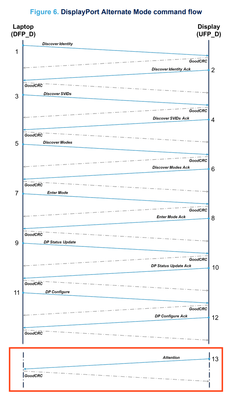

Attention message can only be sent after a successful USB PD explicit contract and after entering the DisplayPort Alternate Mode. When HPD pin is low, and mode is not entered, the stack may silently ignore or queue the Attention message without sending.
I found also according to USB Type-C™ and Power Delivery DisplayPort Alternate Mode, section 4.6, an Attention message with IRQ set to 1 marks the end of USB PD DP Alternate Mode communication and the
beginning of standard DP operation, when all the DP signals are mapped to the Type-C connections.

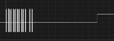

So does the internal UCPD hardware block have the ability to detect voltage level.
I'm fairly certain i'm in a explicit contract since i've entered the mode and have setup the thing to do Display port.
So the only reason from a pure signal perspective that would cause it to not work is if the voltage level was wrong or it wasn't setup properly to read the voltage level.
In the code i'm working on i removed the ADC channels that all the examples had. So usually there's a VBUS sense and a ISense in the examples. Which i don't think really matter for my case since i actually don't want to change the voltage away from just a standard 5v signal.
I'm fairly curtain it must have the ability to measure the voltage, but just checking.
So this is what the transaction looks like and it seems like it does find it's resting voltage. So i should be able to send a attention without problems. Granted it rest at like 0.8V which seems kind of low. The data range is 0-1.0v.
