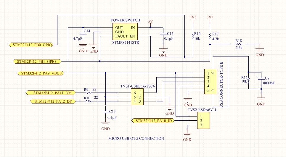

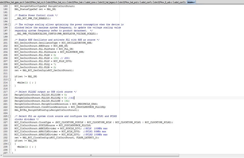

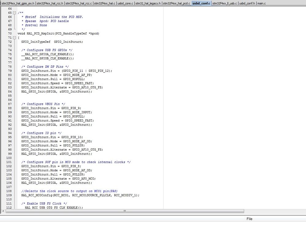

I have tried ''porting over an HS app to a FS app'' and I gave up as it didn't work. I'm currently trying the application at ''STM32Cube_FW_F4_V1.14.0\Projects\STM32F412G-Discovery\Applications\USB_Device'' because it is the same chip ''STM32F412'' but I had to change the clock configuration and the USB pins configuration.
I haven't pulled up D+ or D-, neither in software or in hardware and I am using v_bus sensing as in the code it says ''hpcd.Init.vbus_sensing_enable = 1;''

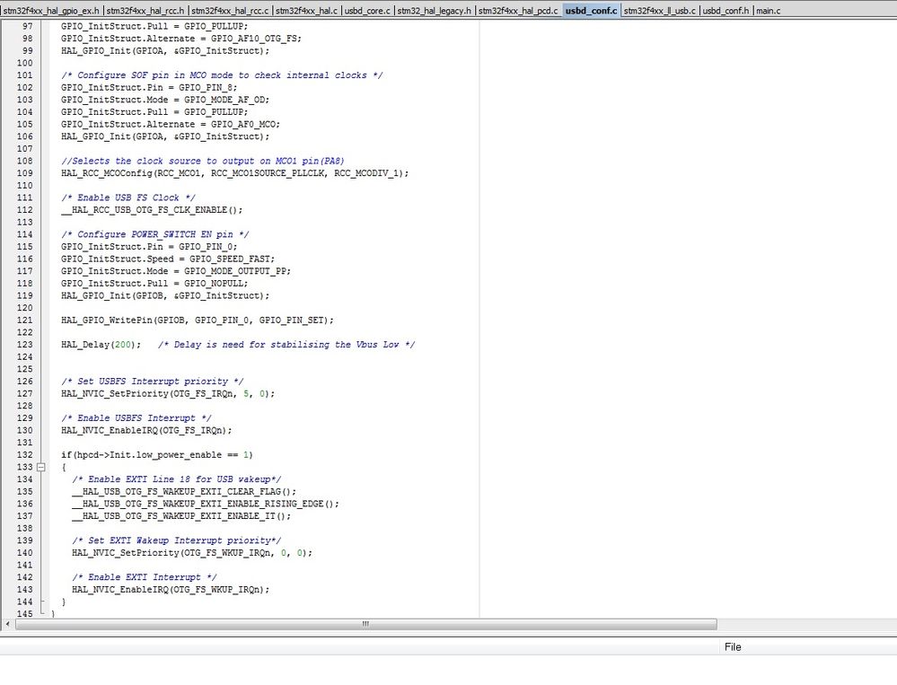

Please find the code images with PLL clock configuration, USB pin configuration and the hardware design.
These are the only changes I've made to the example code available at above link.

The numbers I see here seem okay as far as NUMBER MATH. Make sure that these numbers are within the range of acceptable numbers for your specific part for each setting. I am pretty sure I've seen complaints of CubeMX generating numbers that were GOOD NUMBERS generally but BAD numbers for specific part capabilities.
Don't know if that's been fixed. Try a few combinations that are within the spec but *other* than THESE numbers and see if that helps. Just so long as your math lands on 48Mhz. According to the TREE in the UM your okay with 16Mhz, /8 (/2 to /63) , *192 (50 to 432) , /8 (2 to 15)
You must be doing SOMETHING because your VBUS detect must be working and yanking up the D+ (or D-) line since your analyzer saw traffic from PC to device. (PC knows you plugged SOMETHING on)
Um.... Make sure it is yanking up the D+ line for FS and that you don't have the D- getting yanked up by a line swap, which puts the bus speed off in the weeds....

'Sneaky stuff' - I just looked and that DISCOVERY eval board apparently comes with an LCD. There's a good chance that the CUBE eval software
'STM32Cube_FW_F4_V1.14.0\Projects\STM32F412G-Discovery\Applications\USB_Device' -- AS IS --
probably tries to do some clever stuff with this LCD when it powers up and that means the micro tries to talk to that LCD. And probably expects something BACK from the LCD. If you have no LCD then it doesn't get what it expects and might trigger the infamous ERROR HANDLER FOREVER WHILE LOOP trick I see in some places in the ST stuff. Much like the I/O expander I mentioned. Worth a look maybe ? Let us know how its going.
