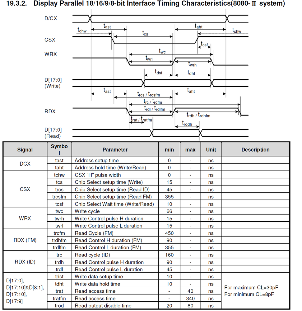

Below is an image of the desired timing for the ILI9341.

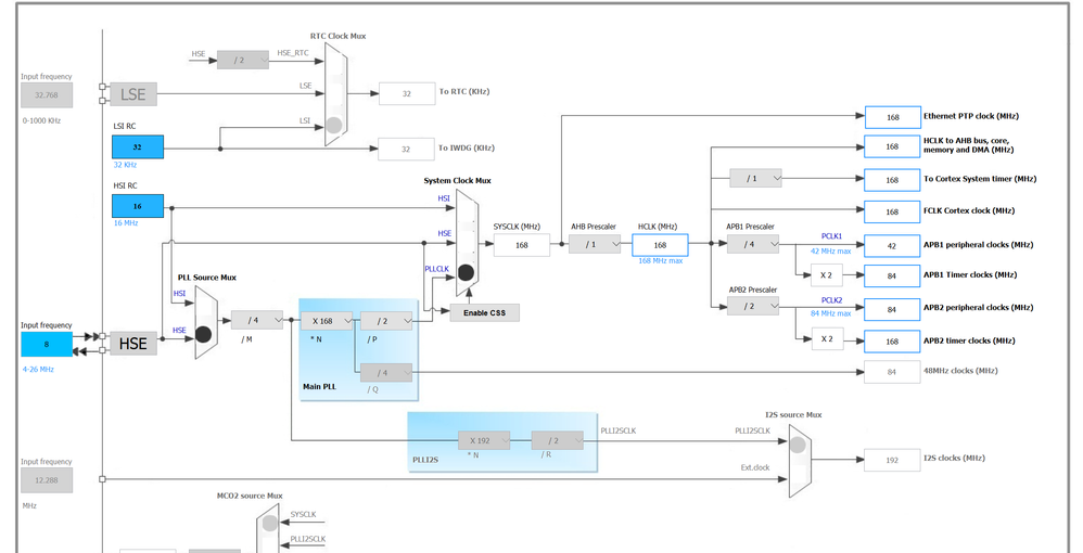

I am using the following setup timing for my stm32f4
However I am aware that I can use Timing.CLKDivision = 16 to slow the HCLK for my FSMC timings.

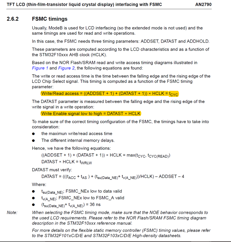

I have gone through those datasheets and all they mention is the following
