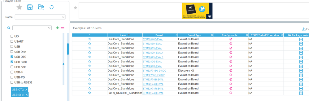

I have a STM32G4 evaluation board. My goal is to read and write to a USB thumb drive (pen drive/MSD device) using an STM32G4 microcontroller (bare-metal).
When I look at the possible USB examples in the CubeIDE, I can't find any examples for MSD devices that are not obsolete and supported in CubeIDE.
Am I searching for the incorrect thing within CubeIDE?
Would you be able to point me to example(s) for this?

Why would those board be obsolete?
But, AFAIK, the'G4 family uses a device-only USB, so you can't implement Host on it.
Choose a different family or a different solution.
