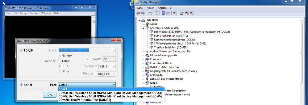

thank you Merle and Vangelis for your contribution. I've tried with PuTTY and after the device switches from application to bootloader comes an error ''Unable to open connection to COM2. Unable to open serial port''. In addition the teraterm is not finding COM2, though the device manager is. Interestingly this error is different from the case when the COM is occupied. The other thing is that the connection is closed i.e. the application which was talking with the stm32f105 prior the bootloader switch is closed. Even if I reopen and reclose the application the COM2 is still not visible from any other application. Only the device manager sees it. Unplug and re-plug is a solution, but it's not very convienient as there should be someone to do the manuel work. Therefore the question is how to make the windows cycle power the USB or issue USB bus reset, and can this be done from the stm32f105 side?
