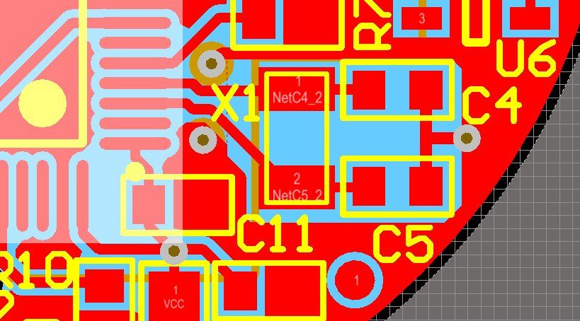

I've a design based on STM32L071CBT6, and I'm using an Abracon Crystal : ABS 07-120-32.768kHz as recommanded in AN2867.
Here's an overview on my PCB, two capacitor (C4 and C5) 2.2nF/COG/50V/5% with the oscillator X1

I've tried to modify capacitors, 4.7pF, 10pF, or remove completly : no effet

With these small capacitance, unable to measure with scope, ... do you have idea or feedback using this crytal, or regarding this configuration

.Sadly I still have struggles with the LSE. The startup of the crystal is very random. Sometimes it starts within a sec, sometimes it starts only when I touch the crystal pin with the oscilloscope probe, and sometimes it won't start at all. I can't understand the logic behind this behavior. I guess I have to redesign/optimize the LSE section of my PCB, and then maybe there is a hope. Maybe, because as I see, a lot of people has unreliable results with it.
