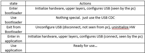

Hello again.
a typical procedure is
in case you don't disconnect (by software) the port before do some change, the pc suposes that usb is connected and with no activity.
After a reset , give some time (few millisecs .. try 10,20....) to MCU before make the USB initialisation .(preferably initialise it after all other peripherals.)
when the device is powered from bus introduce also some delay before try to initialise.
I use all theese methods with no any kind of problem at all, I can press the reset like machinegun!! with no any issue.
Some terminals have another issue.
When disconnect and reconnect USB device, stops working!!! (teraterm not!!)

Vangelis,
thank you very much for your contribution. There are two things which I think are misunderstood. The first thing is that I can press the RESET like machingegun too, because the COM port is not available before the pressing of RESET, after that it's working. The next thing is that I'm switching from application to bootloader via a hyperterm software, where the hyperterm is sending a command to the stm32f105 and then smt32f105 is calling NVIC_SystemReset() to switch to the bootloader and that's it! No deinitializations, no disconect nothing. In the bootloader everything is again initialized and USB is DCD_DevConnect(...)-ed. The device manager blinks and refinds the device, though the hyperterm is not able to find the COM part, no matter if it's 1, 10, 20, 30, any number. After RESET it's working! It's working too if I plug out and then in the usb cable.
