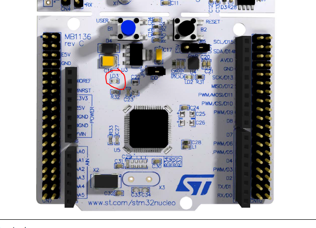

Hi again.
I  wrote about Nucleo 64   I have one of this in my hands.
LD3 at Nucleo64 is tied to 5v  just before 3.3v regulator.  It should be On.
PA14, PA13, GND and NRST pins are used to program the board.

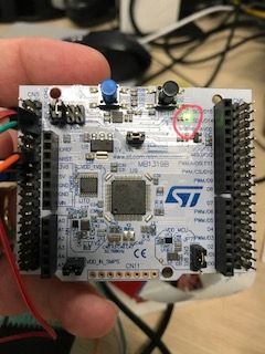

Posted on September 19, 2017 at 17:20
Also writing about Nucleo-64. LD3 circled in red is on.Wires are connected to PA14, PA13, GND and NRST.

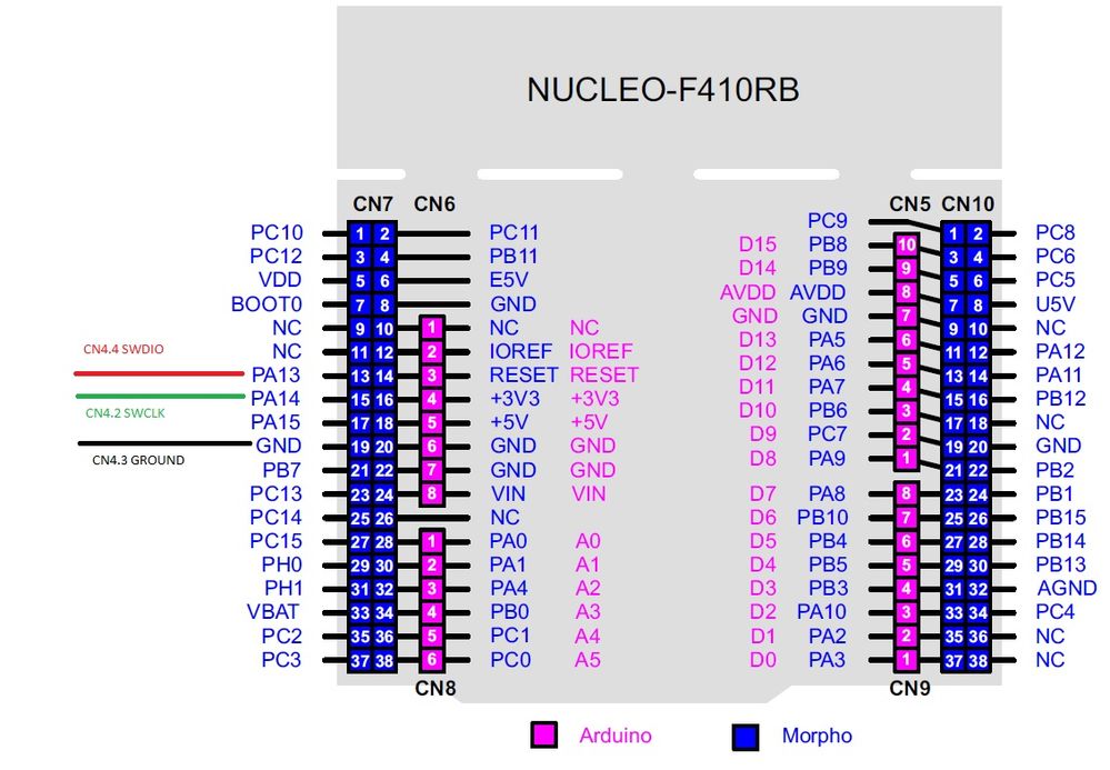

For the NUCLEO-64
CN4.2 PA14 CN7.15 SWCLK
CN4.3 GND
CN4.4 PA13 CN7.13 SWDIO
CN4.5 NRST CN7.14 RESET
