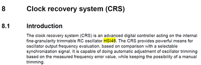

As stated in the reference manual, crystal-less USB requires you to use the HSI48 clock. On the CubeMX clock select screen, this is the "RC 48 MHz" clock.

Yes, the STM32L0x2 series supports crystal-less USB. Look at the Clock Recovery System in the reference manual.
