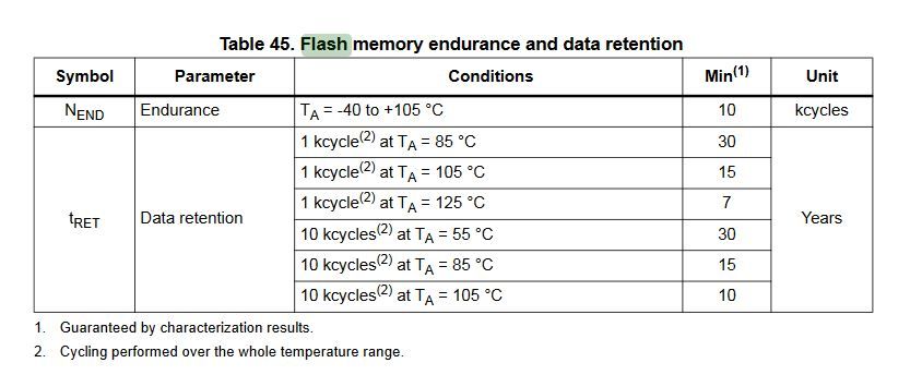

We use this type of storage for both the F series and the G series. Couple questions before you dig yourself in deep.
- How frequently do you need to write the data? ST micro flash can only be erased approximately 1000 times(this number is hard to find) as flash on these devices is really designed for holding code(older flash could be erased in the 100K range.) If the data is only configuration stuff that is updated infrequently you'll be fine. If your writing out error logs the code will have to be much more complex as you will need to track the number of sector erases(the G series refers to these as Pages.)
- If you decide that you will not burn the flash out by writing to many times, then find how big the Page(or Sector) sizes are and how large do the flash writes need to be. F series allowed you to write 4 bytes at a time where the G series that we use need to be 8 bytes at a time. Size your data structures accordingly so you keep everything aligned.

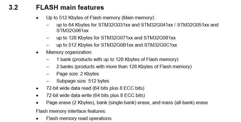

// We are writing 8 bytes at a time to flash because the STM32G0B0RE can
// only write 8 bytes at a time.
