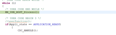

Since communication with the GMSL module is integral to the project, I must utilize the STM32, as using a Raspberry Pi is not an option. I've already developed a project using USB HOST functionality. However, I'm encountering an issue where the Appli_state remains in a state of not being ready.
2024-05-09 4:13 AM

@sana1 wrote:the Appli_state remains in a state of not being ready.
So what state is it in?

while (1)
/* USER CODE END WHILE */
MX_USB_HOST_Process();
/* USER CODE BEGIN 3 */
//userfunction();
if(Appli_state == APPLICATION_READY)
CDC_HANDLE();
