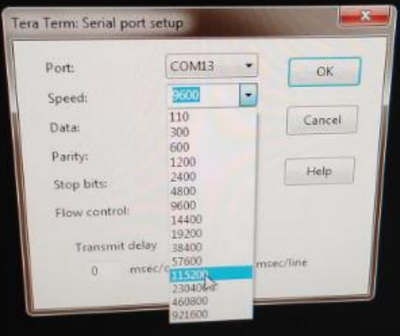

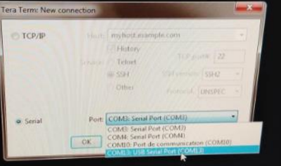

In my graduation project, I'm utilizing the STM32H735_DK microcontroller to communicate with a GMSL (Generalized Memory Scalable Logic) device. Typically, these devices are configured using terminal programs like Putty or TeraTerm. Commands, such as "PICT START," are sent via a USB A to USB B cable from a PC to the GMSL.

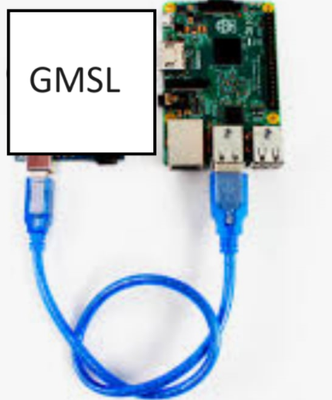

Despite my attempts to replicate this communication using UART and USB CDC with the STM32, I've encountered difficulties. Conversely, my friend successfully communicated with a GMSL device using a Raspberry Pi via a serial port.

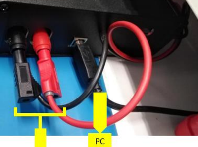

Typically, commands are sent to the GMSL via Tera Term. However, I'm now aiming to send the same commands using an STM32 microcontroller instead. I'm uncertain about the exact protocol I should be working with. The GMSL has a port B similar to the one shown in the photo I provided earlier.
and my friend send the same caamnd via port usb from rasberry to GMSL

You need to provide details on how you establish communication between the GMSL device and at least using your raspberry? Attach the datasheet of GMSIL device. Unfortunately, pictures attached does not explain your hardware setup. Knowing the connector cannot allow us to predict the protocol used.

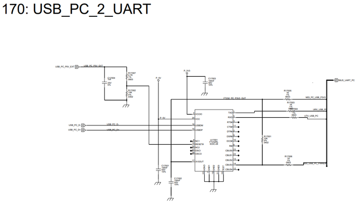

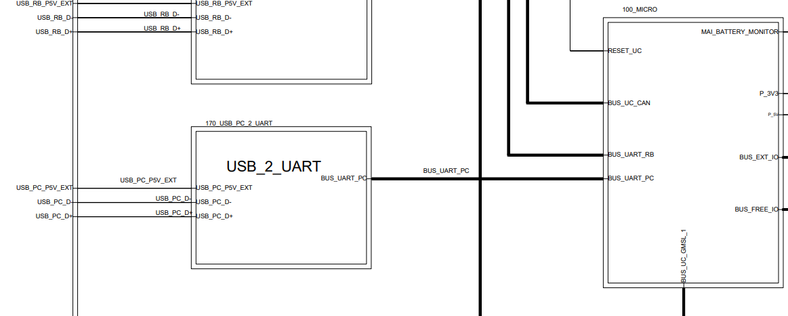

I have gathered information from the schematic of the GMSL UART connection to an MCU (Micro 100). This MCU is then linked to uart then PC via USB to receive commands through Tera Term or PuTTY. My question is about configuring the USB on the STM32. Should I set it up as a USB CDC device or host, or is there another configuration that I should consider? I apologize for any confusion in my explanation; I'm new to working with STM and this project marks my first venture into this field. Any guidance would be greatly appreciated.
