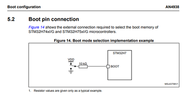

I'm a little confused, the STM32H747 microcontroller has only one BOOT pin: BOOT0. Right?
At what logic level should I connect the BOOT0 pin to be able to use the bootloader over I2C?

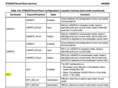

I read the AN2606 and found that pattern 10 should be used for the microcontroller.
But it's still not clear to me how I should connect the BOOT0 pin. Assuming it needs to be wired at a logical high level, can I leave it high even when I don't want to activate the bootloader?
