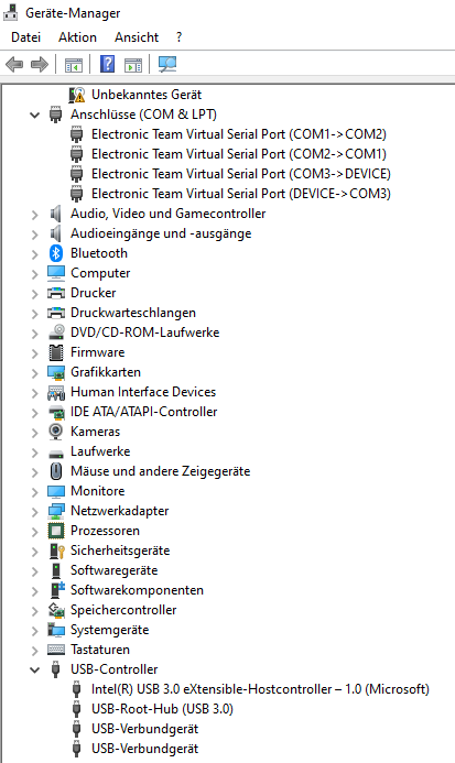

When you plug the board into a Windows PC (with the firmware running) what do you see in Device Manager? in UsbView?
2023-11-04 1:45 PM - edited 2023-11-04 1:51 PM
nothing is shown in device maneger, as if i had not connected the board to anything
2023-11-04 3:10 PM
There's some Unbekanntes Gerat. Is it the board? Will it disappear when you unplug the board?
2023-11-05 1:21 AM
No, this is a different device that I have been using for months.
