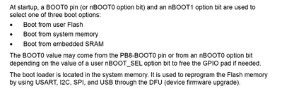

> Does the bootloader recognize if there is USB connected automatically?
If pin boot0 is hi at start/reset , bootloader tries all possible inputs (see rm ).
If boot0 lo , flash/user program is started.
So set pin PB8 with a pullup to VDD hi , seems on the board is no pullup.
Or use a jumper cable from JP7 to VDD on the pin header for boot0 .
2024-03-18 7:53 AM - edited 2024-03-18 8:04 AM

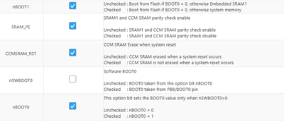

2024-03-18 7:53 AM
You're not in the mode that you highlighted. You want nSWBOOT0=0.
with nSWBOOT0=1 and BOOT0=0, you are booting to main flash (regardless of nBOOT0 and nBOOT1 settings).
Yes, it will auto detect and connect.
2024-03-18 7:57 AM - edited 2024-03-18 8:02 AM
Here is the configuration I'm using now, but same result:
To make it more clear JP7 is connecting the BOOT.
