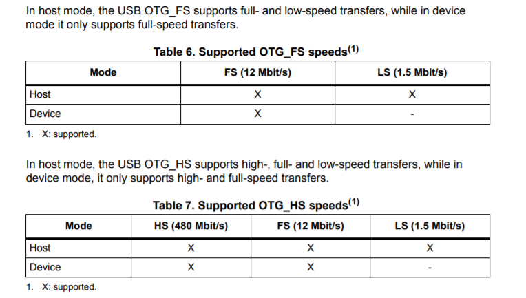

2018-06-25 3:51 AM
Dear
pavel_a
,Unfortunately, low speed transfers are not supported in device mode:
Khouloud.
